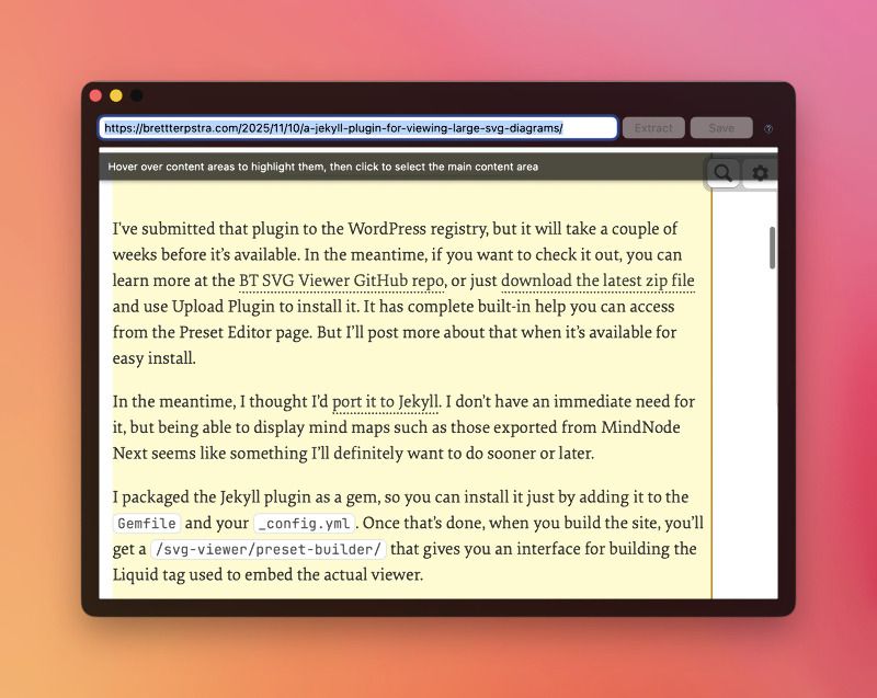

Step 3: Load and Navigate
Click Extract or press to load the website. Once loaded, you can:
  • Navigate the site using Command+Click on links
  • Hover over content areas to see them highlighted
  • Click on the main content area you want to extract styles from
The main content area you select should only contain headlines, paragraphs, lists, etc. Do not select a content area that contains menus, sidebars, or other extraneous content. Often a headline will be in a separate container from the regular paragraph content. In these cases, first try selecting the smallest container that still contains both. If the results are poor, click Extract again and re-select just the container that holds the paragraphs.

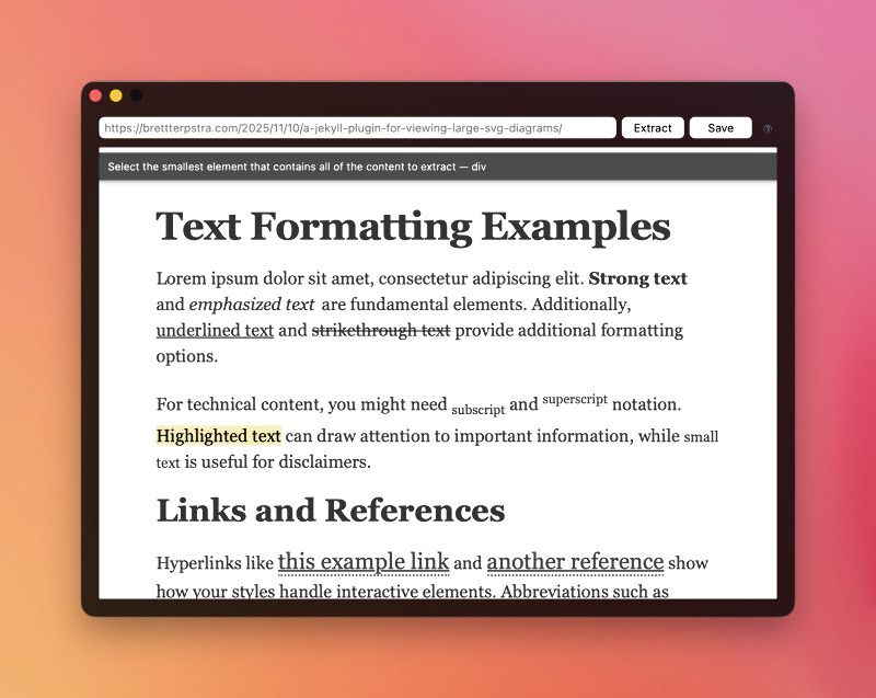

Step 4: Extract Styles
When you click the content area, the styles that apply to that area will be extracted. The preview will reload with a generic page that showcases all common HTML elements and how the extracted styles will apply to them.
You can then save this Custom Style to your Custom CSS folder for use in any document. Click the Save button or press +S to save. The style will be named based on the domain of the URL you entered.
