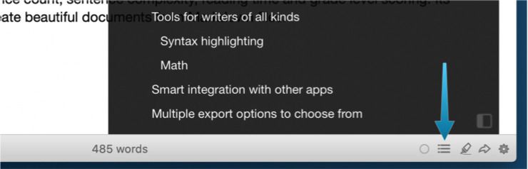

If your document has headers in it, a list button appears in the toolbar. Click it to expand the Table of Contents; click a headline to jump to that section of the preview. Use J/K (down/up) to move through the list, and or O to jump to the highlighted header.

Pressing +T also opens (or closes) the Table of Contents.

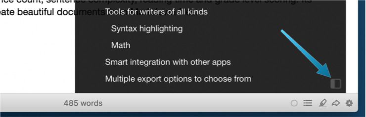

When in full-screen mode, the table of contents appears as a fixed side bar instead of a popup menu. To use that layout in a regular windowed preview, use the full-screen toggle in the lower-right of the TOC panel.

In a normal window, click the icon at the bottom of the TOC panel to dock it as a sidebar; click the icon at the top of the sidebar to return it to popup mode.
