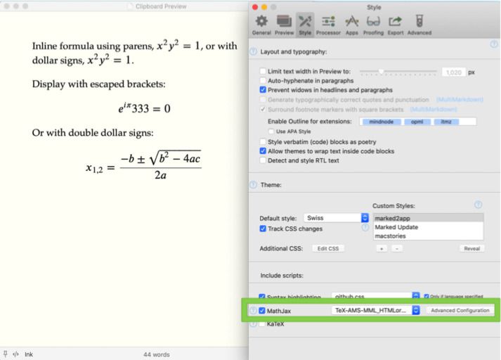

By turning on MathJax in the Marked Settings, Style pane, the necessary scripts and CSS will be included in the preview. Then MultiMarkdown math syntax can be used in your Markdown document and the results will be displayed.

The MathJax Source popup in Marked Settings, Style pane lets you choose:
  • Local – uses the ES5 tex-chtml.js component from the app bundle.
  • CDN – loads the same component from the CDN. This requires an Internet connection.

MathJax advanced configuration
You can apply additional custom configurations on top of Marked’s defaults by adding a valid JSON object in the Advanced Configuration field. This field is merged into the MathJax v3 configuration object (window.MathJax) before MathJax loads. It can contain any options supported by MathJax v3, for example:
    "tex": {
        "inlineMath": [["$","$"],["\\\\(","\\\\)"]],
        "displayMath": [["$$","$$"],["\\\\[","\\\\]"]],
        "macros": {
            "tr": "{\\\\scriptscriptstyle\\\\mathrm{T}}"
        "packages": { "[+]": ["physics"] }

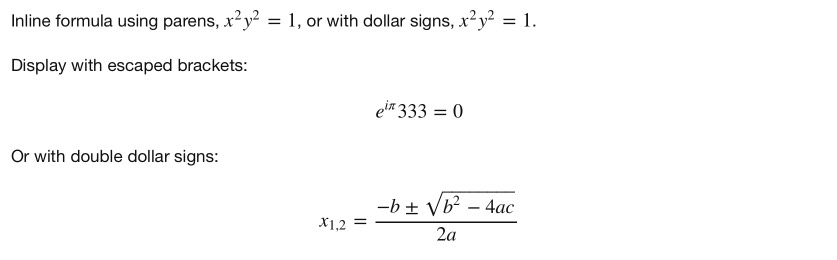

This example adjusts TeX delimiters, adds a \tr macro, and enables the physics package in addition to the default set. With these settings, all of the following renders properly:
Inline formula using parens, \\\\({x}^{2} {y}^{2}=1\\\\), or with dollar signs, ${x}^{2} {y}^{2}=1$.
Display with escaped brackets:
\\\\[ {e}^{i\pi } 333=0 \label{testme} \\\\]
Or with double dollar signs:
$${x}_{1,2}=\\frac{-b\pm \sqrt{{b}^{2}-4ac}}{2a}$$
The additional configuration extends the existing object, so only the properties specified will be overridden. Unspecified options will remain at the default for the current preset.
Note that using the MultiMarkdown processor with non-standard delimiters, characters inside the expression are parsed, so symbols like * and ^ will cause typographic changes that will break the MathJax processor. The best solution in these cases is to use the Discount processor in Processor settings.
